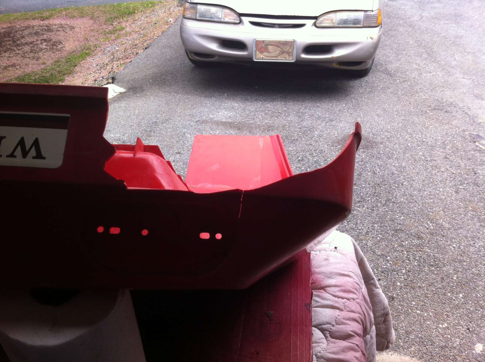

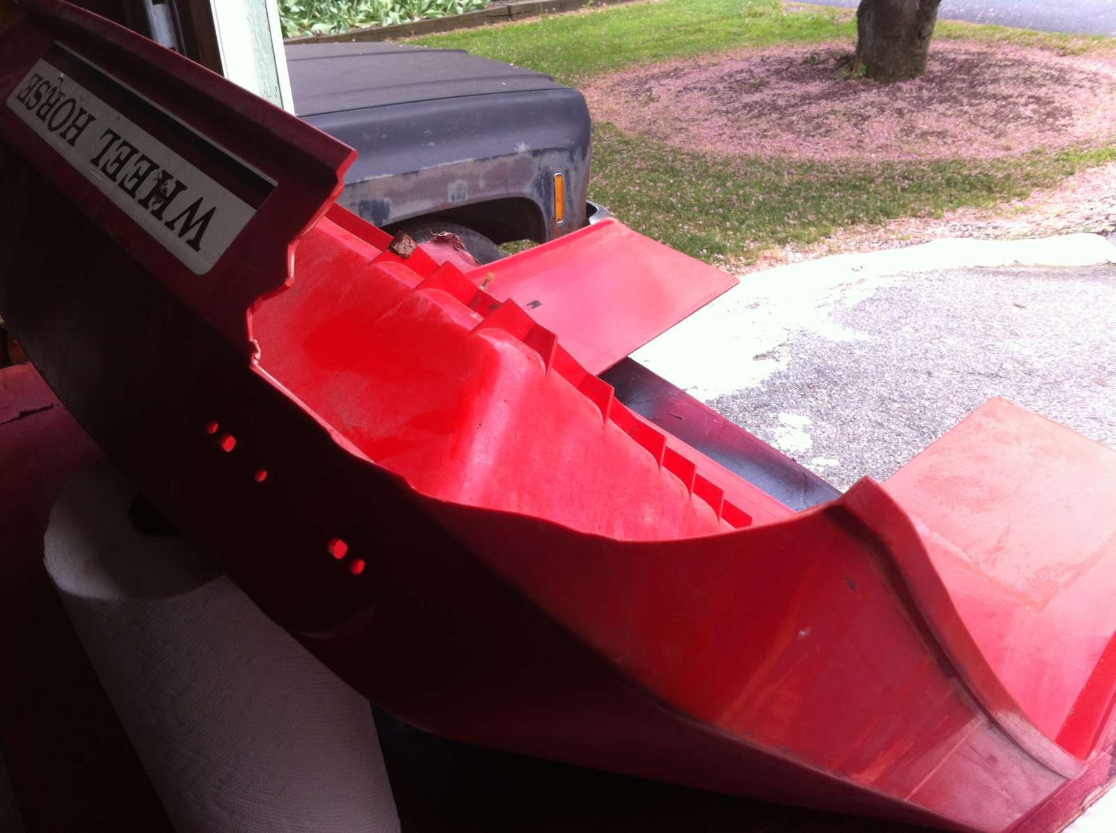

Ok starting to fix this junk fender for the 225
Updates to come.

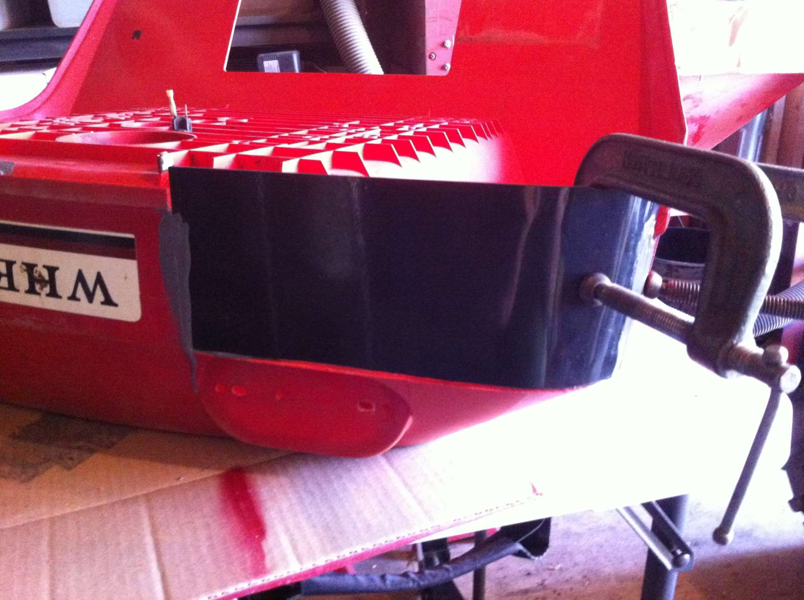

I have a sheet of 1/8 ABS and I am fabricating a patch. I think my trusty JB Weld will handle the job.

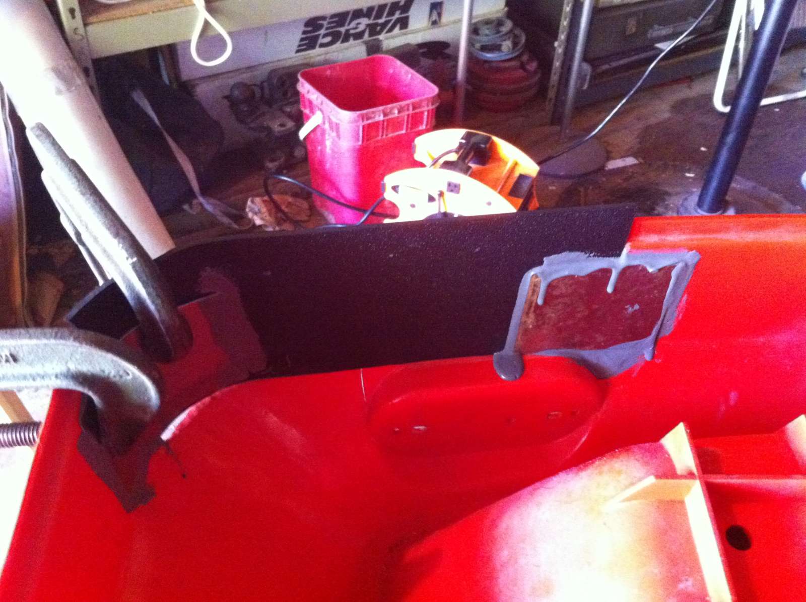

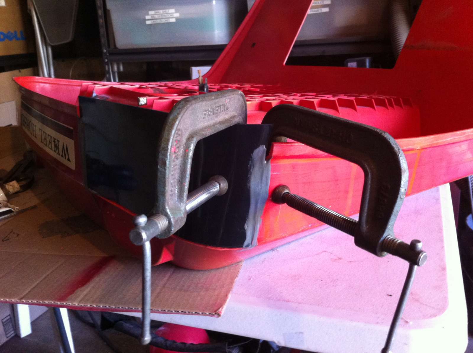

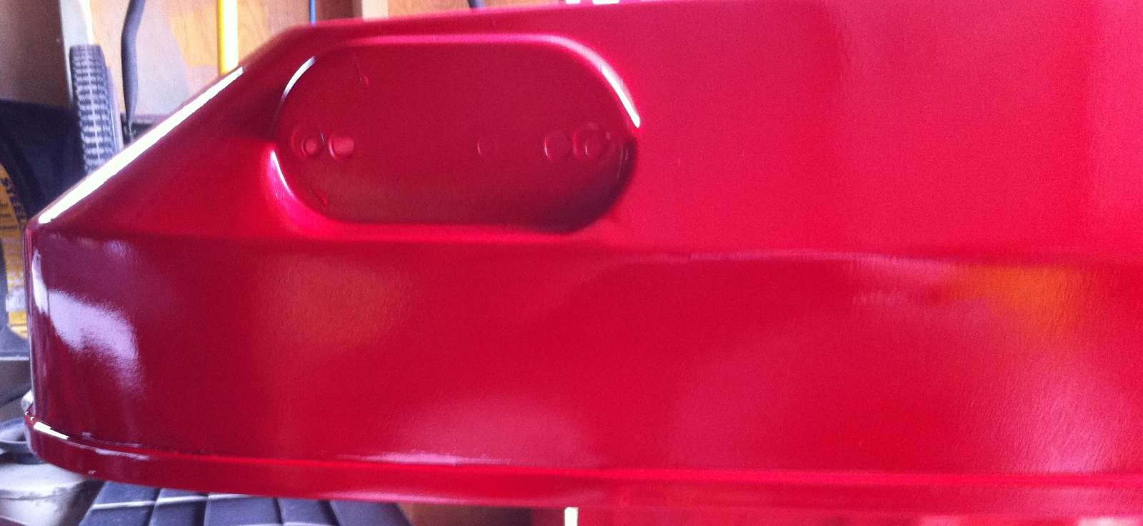

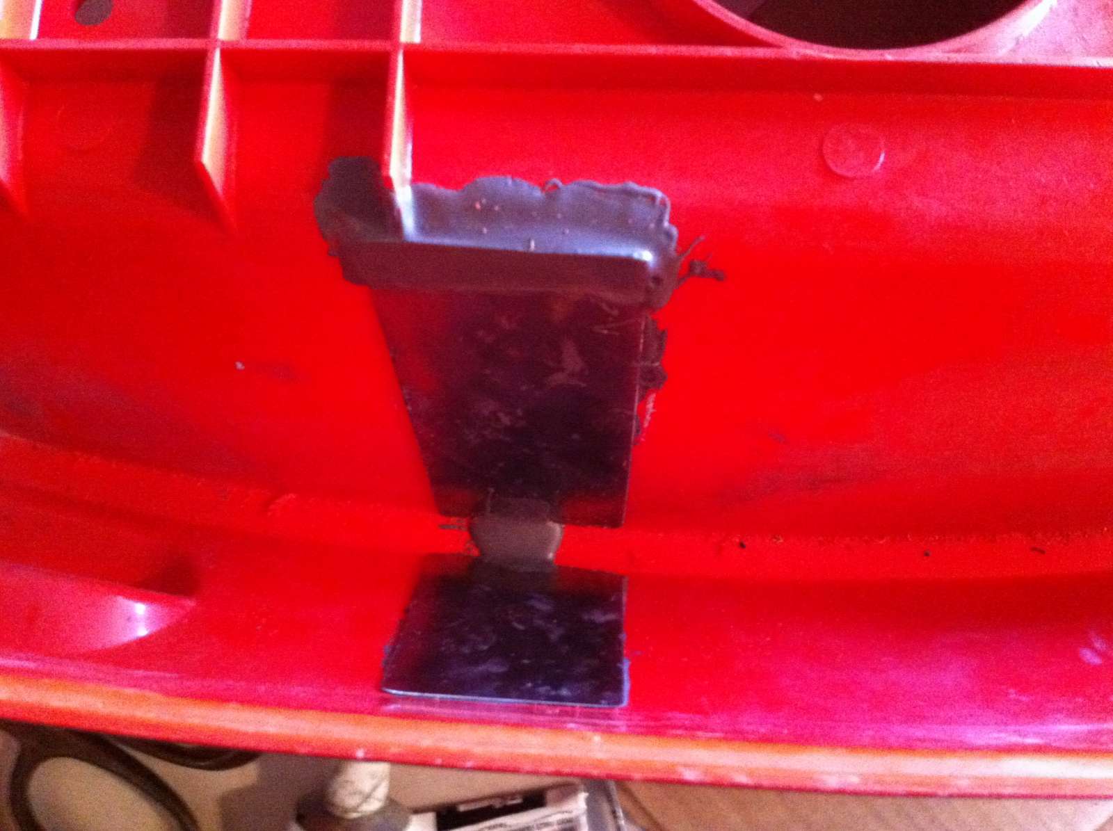

14 May 2015 19:54 - 26 May 2015 16:04 #4499 by GT 14
Replied by GT 14 on topic Plastic fender repair
Here we go
Squared up the area, and cut and shaped 1/8" ABS. Used heat gun to get the curve.
Decided that strength was needed so I am using small squares of sheet metal.
Covered the entire piece of metal with JB and clamped.
Also repaired a large crack down the middle with same process.

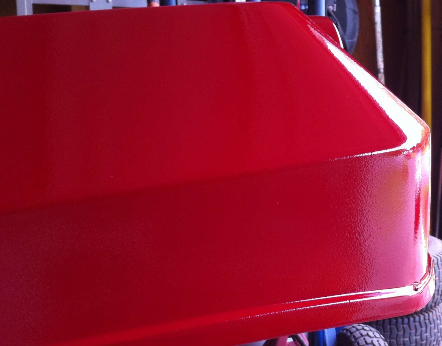

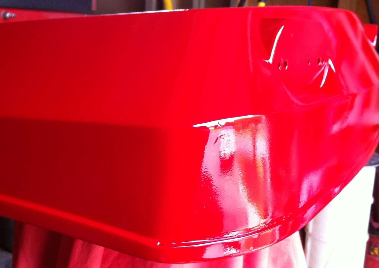

Finally the new fender has emerged!
