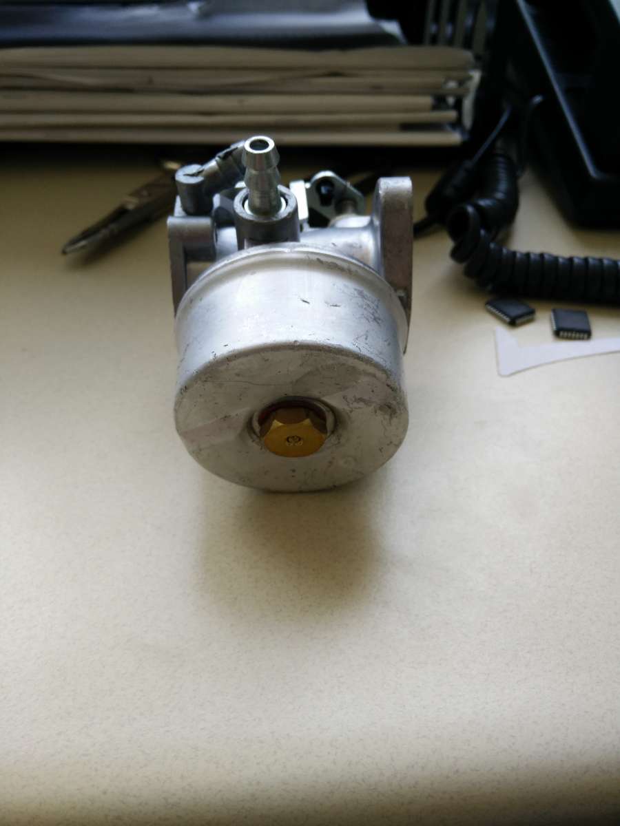

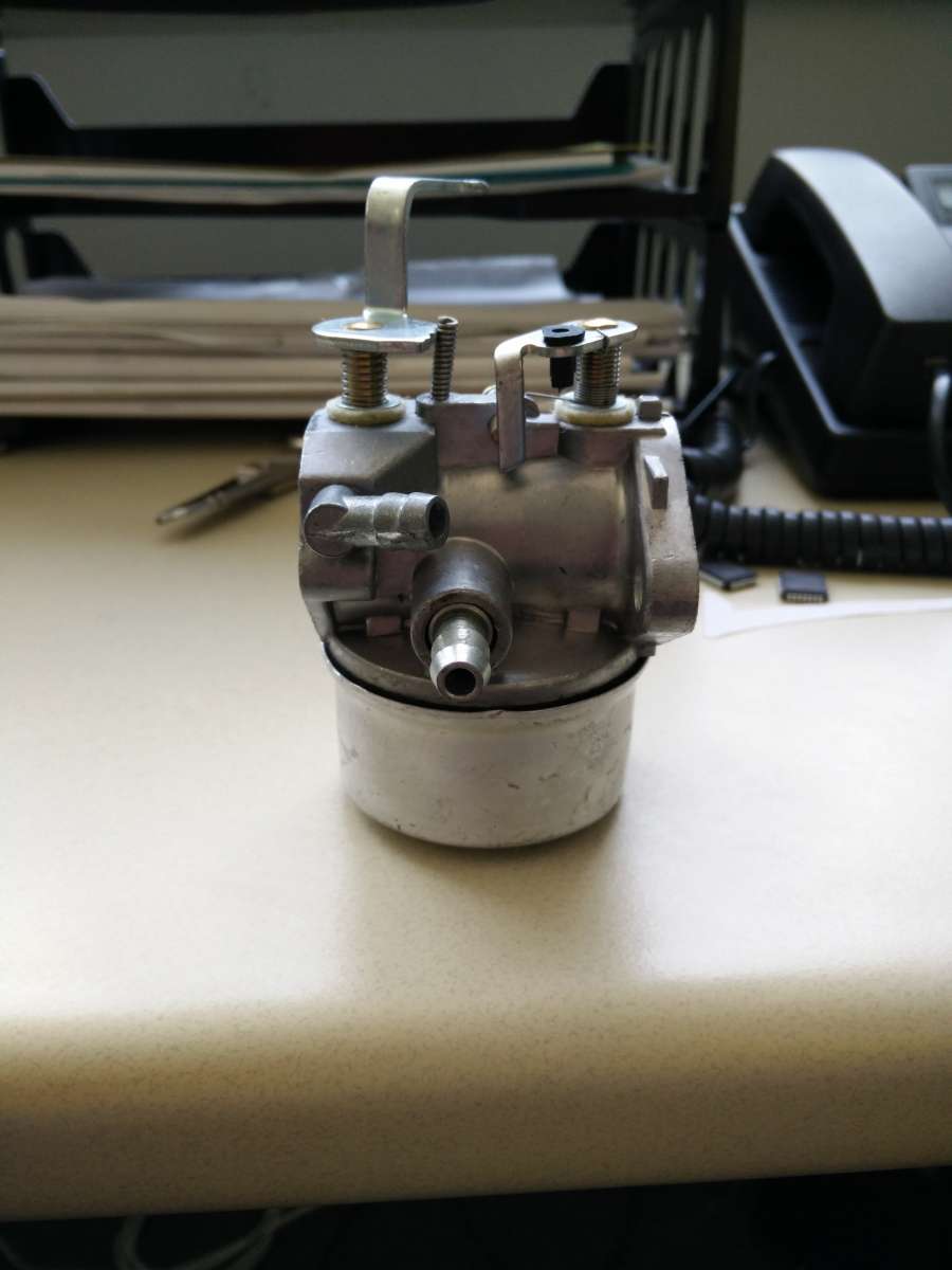

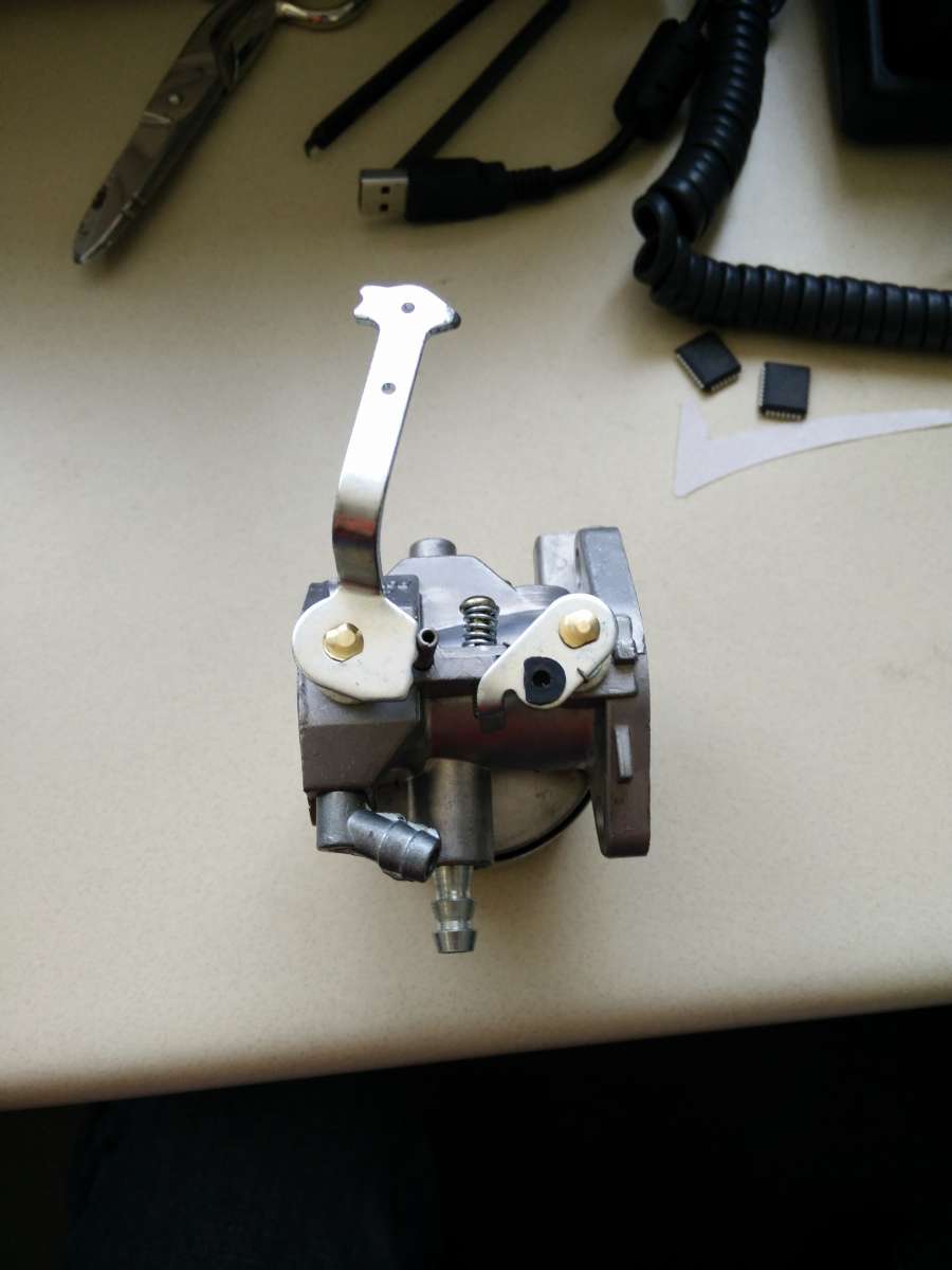

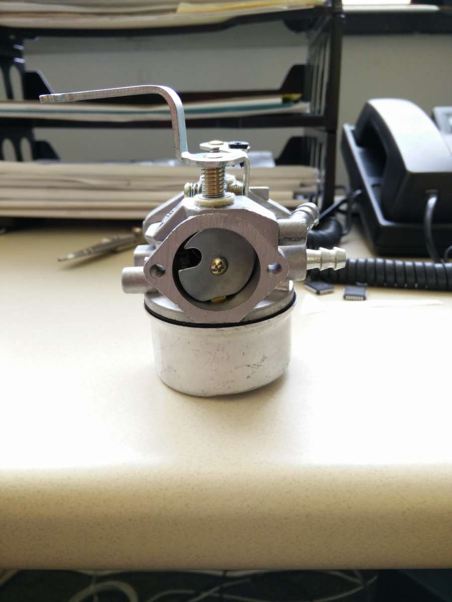

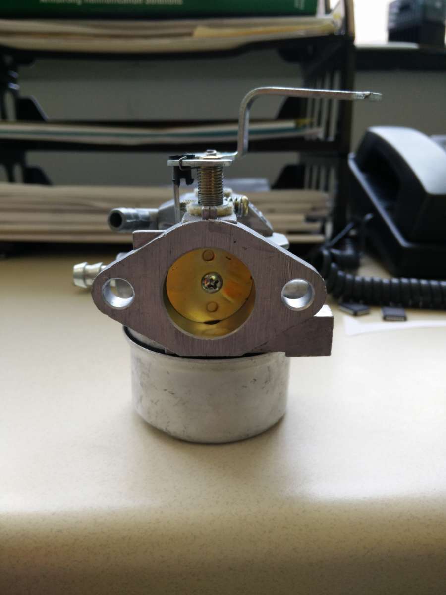

New Techy carbs was created by AJ WH Ranger

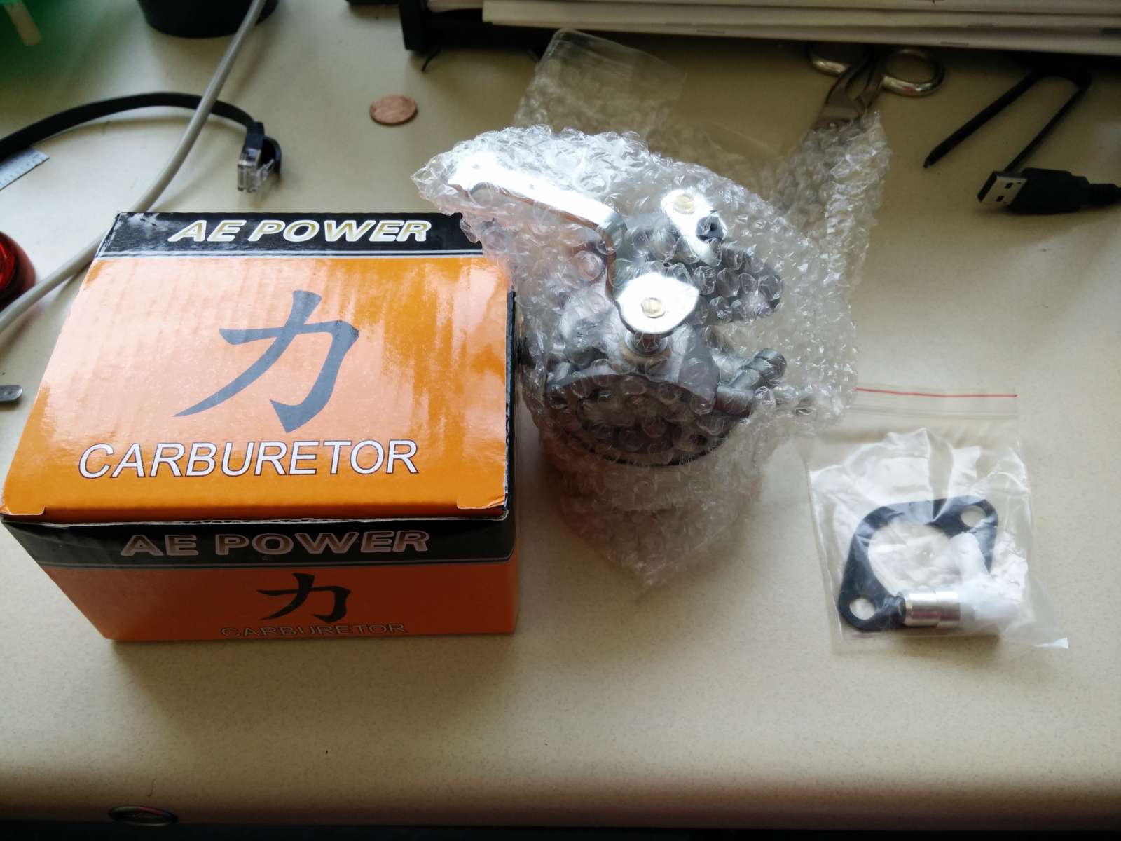

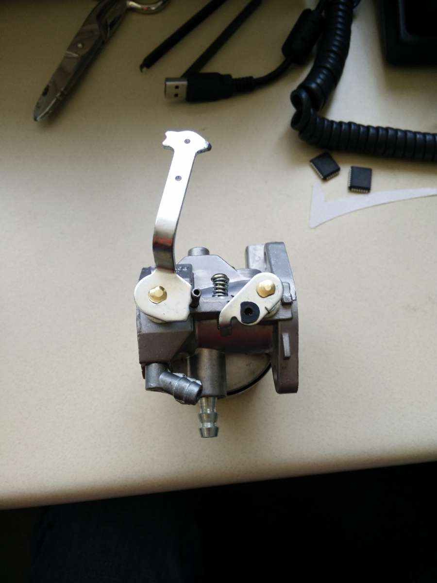

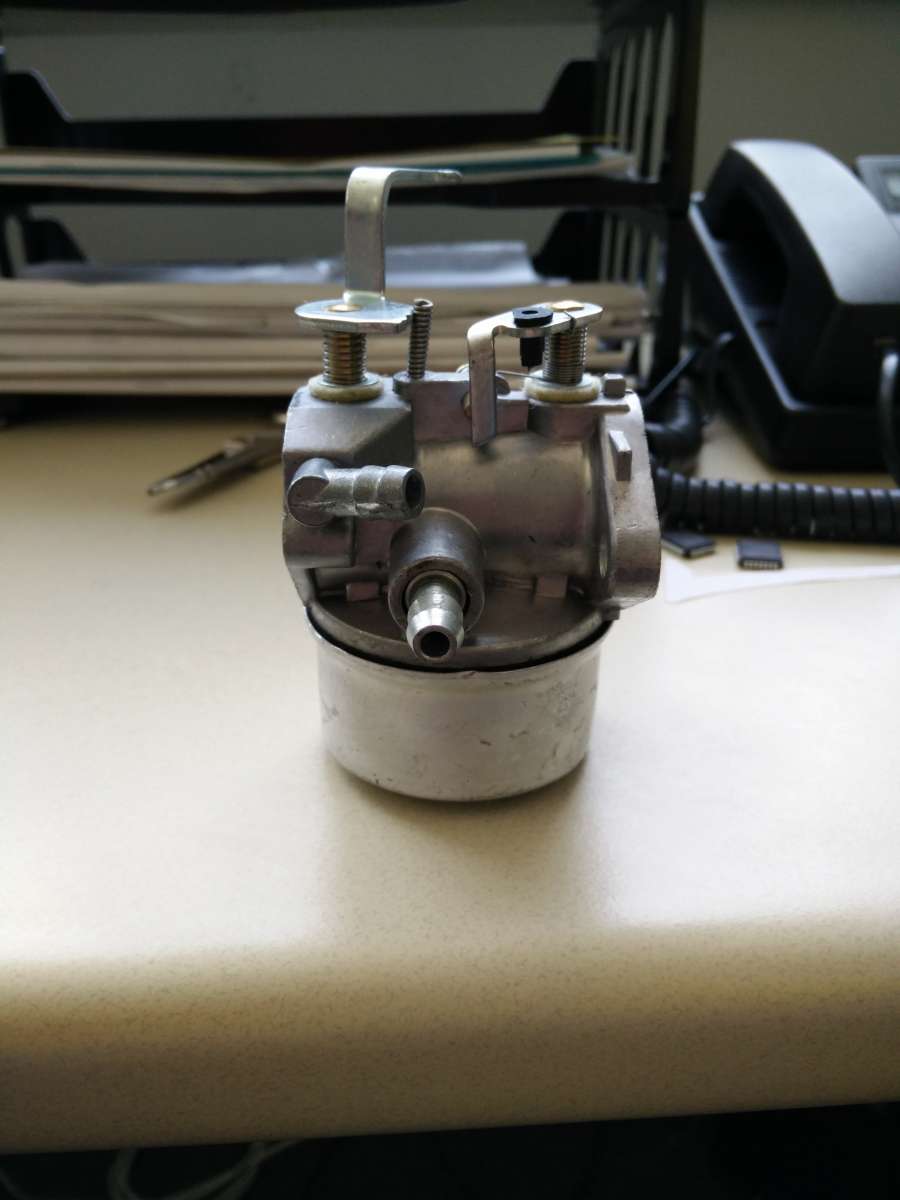

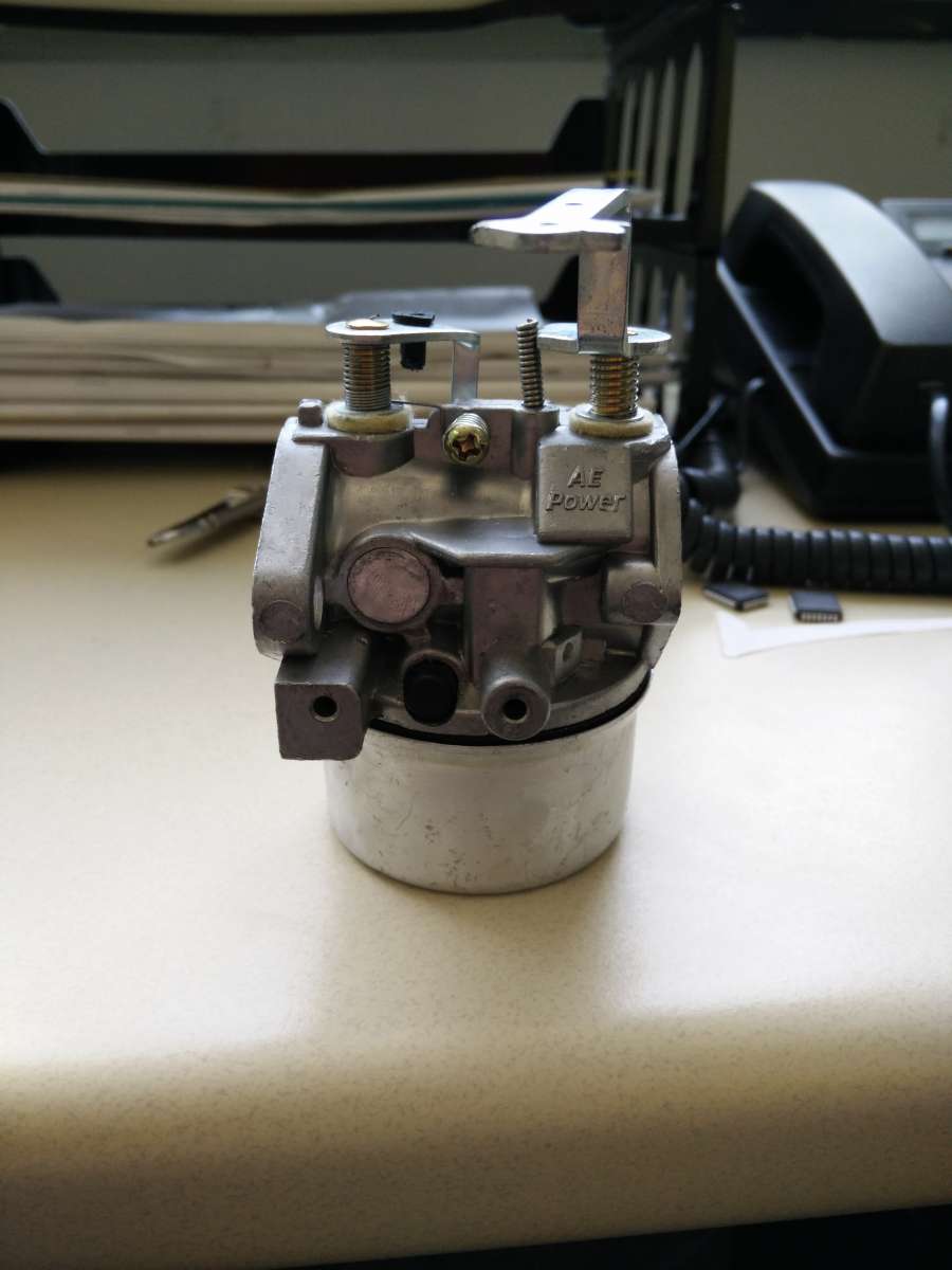

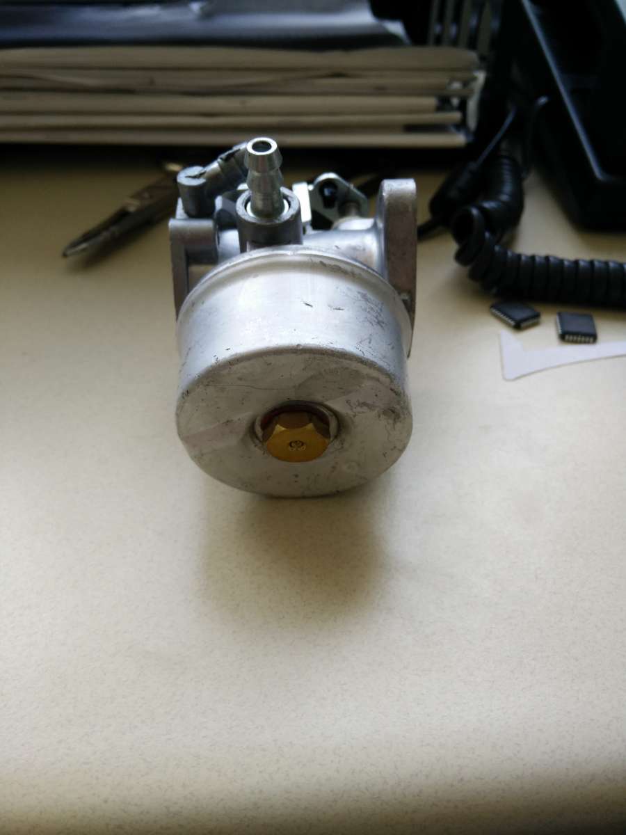

Here are the pictures of the new techy carbs I bought. They can be found here
www.ebay.com/itm/NEW-TECUMSEH-TROY-BILT-...&hash=item5b12c7c715
First thing I noticed is there is no adjustment screws like the originals??? :confused1

04 Jun 2015 12:24 #5334 by JustinW.73
Replied by JustinW.73 on topic New Techy carbs
Ya looks to me like those are the wrong ones. Those are the newer style that are non adjustable (obviously). Those look like ones that are for the snowblowers that had techys on. You need one like this:http://www.ebay.com/itm/Carburetor-Tecumseh-632334-632334A-Craftsman-HM70-HM80-HMSK80-Adjustable-Carb-/281588201440?pt=LH_DefaultDomain_0&hash=item418ff6f7e0
But, what engine do you have? All I need is model #'s. If its a HM70 HM80 or HMSK80 then it will work. If its not one of those then give me the model. I don't need serial.

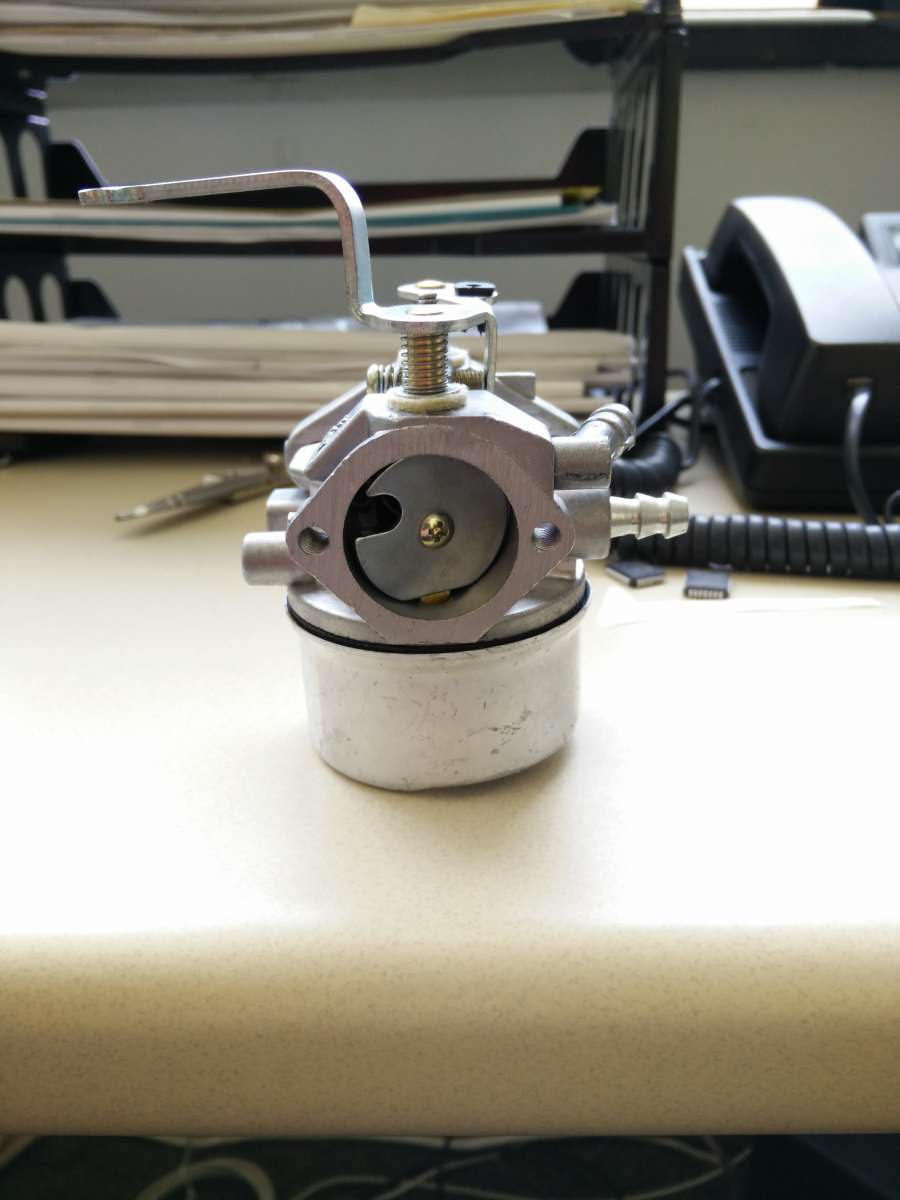

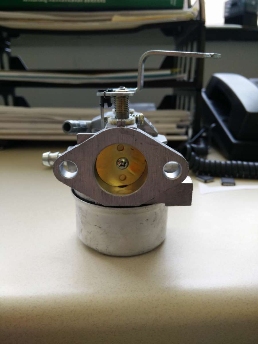

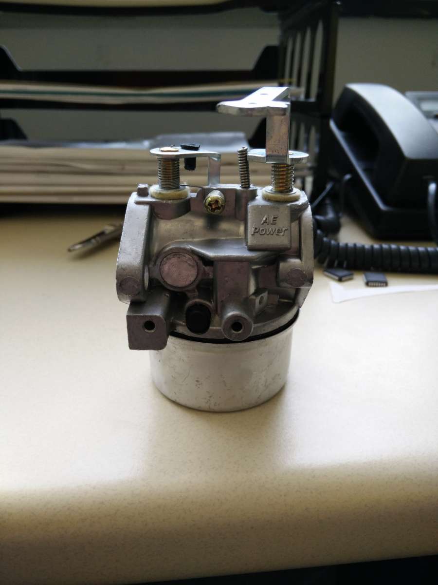

04 Jun 2015 13:19 #5337 by AJ WH Ranger
Replied by AJ WH Ranger on topic New Techy carbs
04 Jun 2015 13:38 #5338 by M Bailey
Replied by M Bailey on topic New Techy carbs
AJ that is not the one originally listed. That looks like a CARB (California Air Resource Board) compliant carburetor required by the state of Kalifornia. Try one out and if they don't work as expected let me know and I'll take them off your hands, I need a couple of carbs for my DR Trimmer and chipper which those would be well suited for.
