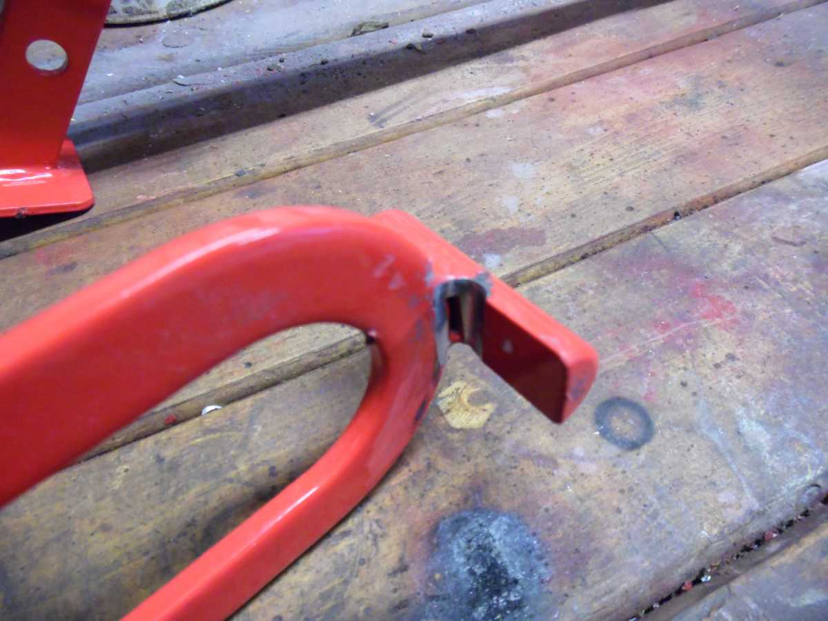

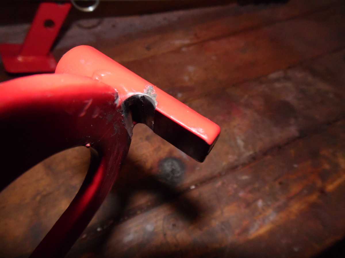

Every time I use this think it's hard to believe I put off getting one for so long. I'd always before used tire spoons, screwdrivers and hammers but age, arthritis and bad back forced the issue. Item #61179 , the changer retails for $39.99 but 20% coupons are always available bringing it down to $31.99. The changer works fine right out of the box provided it is solidly mounted. The machine well constructed and so far has worked well on 8 and 12 inch tires ranging from 4.80-8 to 23X8.50-12 so far. I have a set of 23X10.50-12 six ply ag tires to mount later in the week so we'll see how well it handles them. The only modification made was to the mounting bar to improve tracking on the rim and minimize paint damage. The area in the photo was ground out with an angle grinder and polished with a Dremel tool. For ease of use and cost I give it 4.5 stars because nothing is perfect!

Wonder if you could find a piece of nylon to glue in that slot as a buffer to the paint? Wasn't my idea, my tire changer has replaceable tips on it already. :)

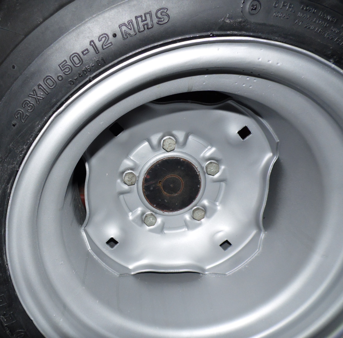

As a followup I tried to use the HF changer for the new Deestone 23X10.50-12 tires for the 416-8 and it just wouldn't work. The 6 ply tire was so wide and stiff that it was impossible to get the mounting bar into place on the 8-1/2" rim. A 2 ply tire might have been doable but not these.
