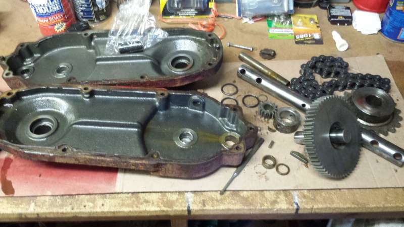

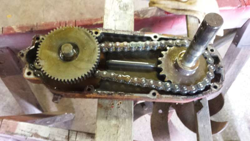

For those who may be looking inside a tiller.....
Looks pretty straight forward.....I needed to put some seals in....takes 2 each side for the main drive and 1 for the input.....

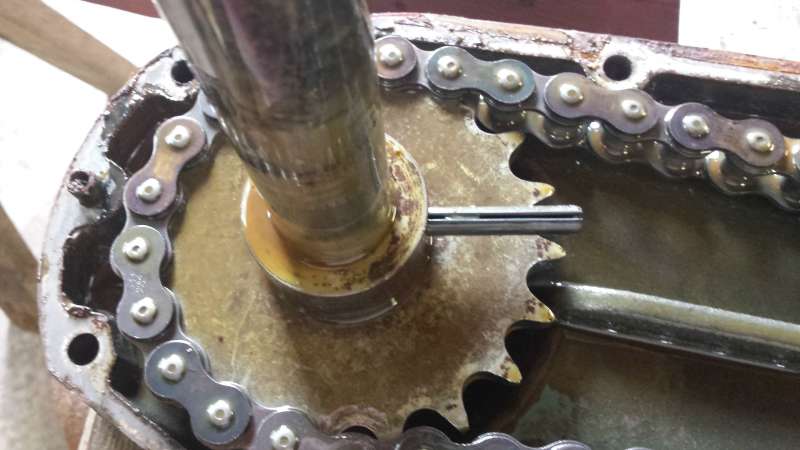

this collar is held in place by a pin....
parts all laid out......
Seals are CR 12330 (4) and CR 7410 (1) I believe.....well pretty sure....at least that is what I have ordered....

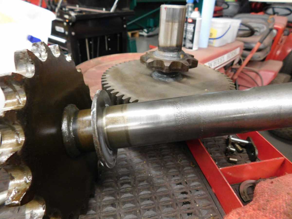

It is 4-16-2016 and I am adding something to your post Bob. :)
This tiller is a 07-36TL03, it was built from 1984-1989. The gears in this tiller are factory machine welded and don't come off.

21 Mar 2015 21:51 #1533 by Scott
Replied by Scott on topic Tiller guts
Nice! Thank you for showing these pics. Were building a nice how too list. If the weather stays nice I have a few I would like to ad.

I have a bearing list also...but these bearings looked in such fine shape I'm not replacing them.....one thing worth mentioning....the main shaft where the pins hold the tine assembly get cratered a little and need ground a bit for the case to come off easily. One tine is broken...gonna try and make one then weld it in place....or maybe purchase a D series tine and weld it on....those can still be bought. Was also thinking about using a mower blade...not sure if they can be torched and bent or not....any ideas on that?

22 Mar 2015 07:49 #1547 by M Bailey
Replied by M Bailey on topic Tiller guts
Never seen the insides of one before, surprised they are that simple. Thanks Bob!
22 Mar 2015 08:47 #1557 by Kyblue
Replied by Kyblue on topic Tiller guts
They really are simple ... I'll need to put a chain in mine this winter.
Be sure when you put the seals in, mine were in different directions ... one kept oil in, one kept dirt out ... not sure if that's factory or if the p/o did that...they were leaking so....might not be so good...I did put put them back like that, and the the new seals don't leak. However I have a pulley shaft seal leaking now...
