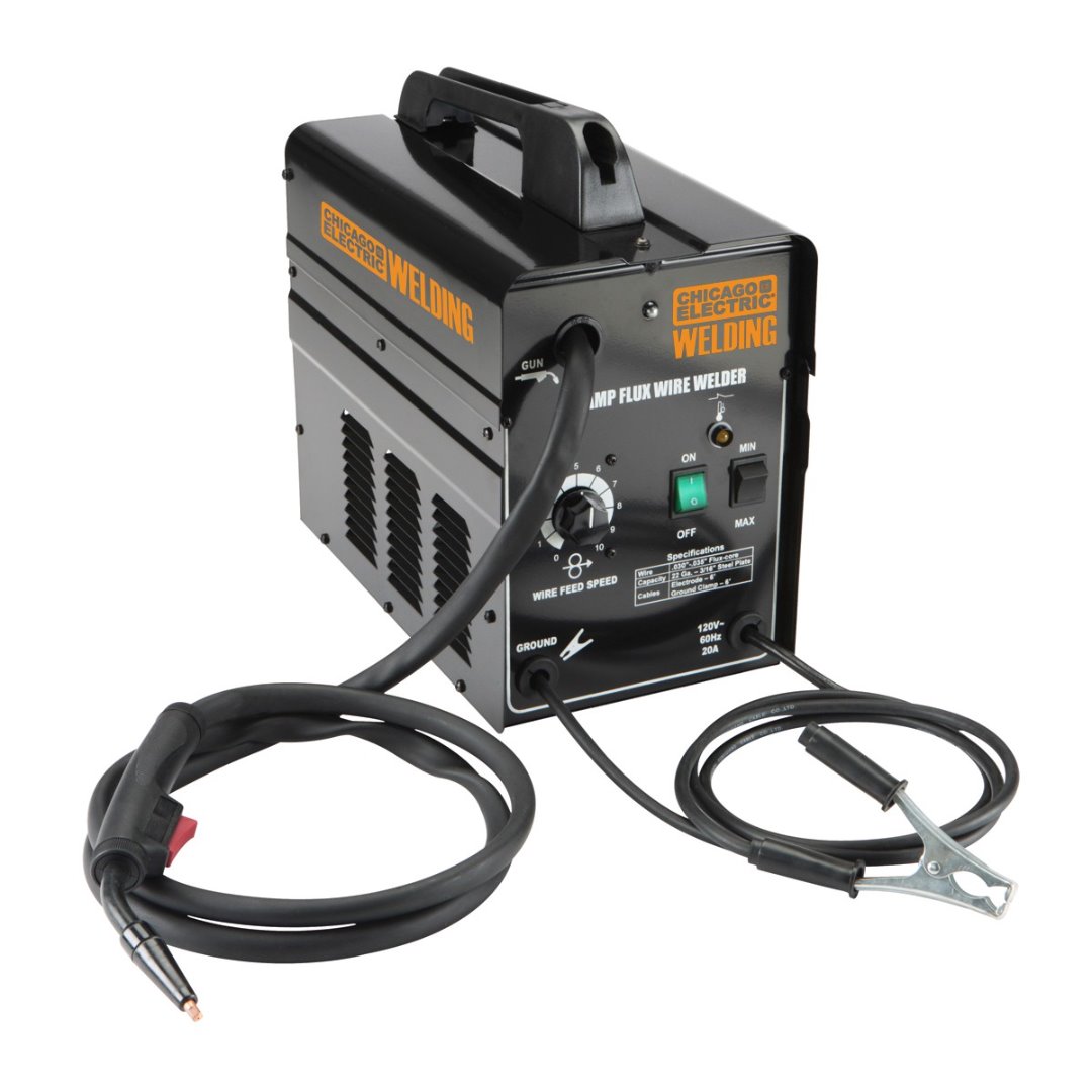

Here's a photo.

Trouty56 the gas cup I am talking about is on the tip of the gun. it is used to keep gas on the weld when the puddle is mouton. But with this welder ( flux core wire) the cup is not needed as there is no gas . the flux in the wire is burned creating a shield for the puddle. Also the gas cup causes the wire stick out to be to long (1/2 in or so) removing the gun tip allows for better control of the weld puddle plus visibility is better. So I removed the tip and tossed it..The tip shown in the photo above is not the one you get with a new machine, it does not show the larger cup.
