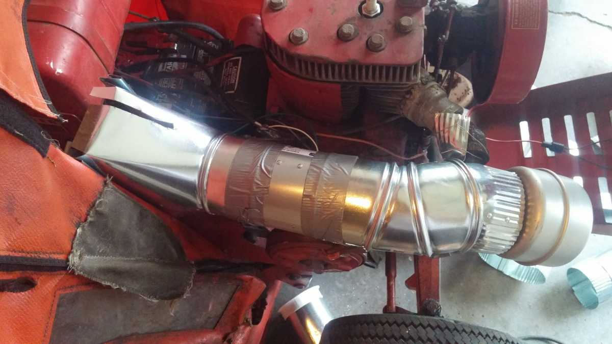

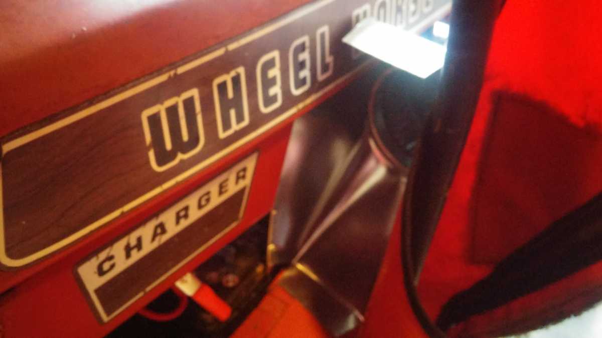

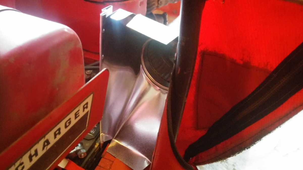

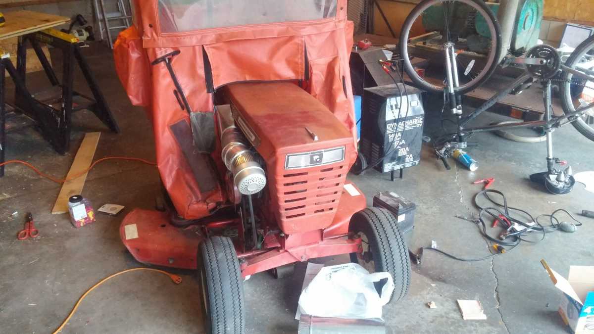

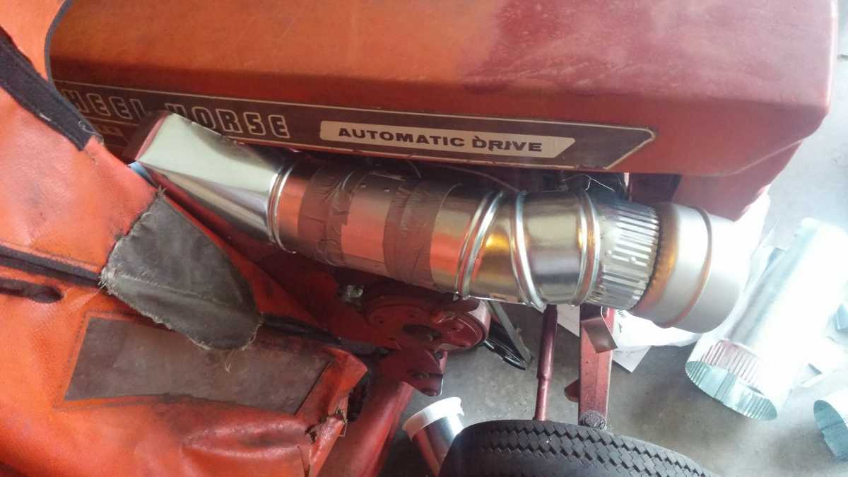

Alright some some of you might remember when I made a post back last winter to see if anyone had made different style heaters whether it would be electric or only use the heat from the engine. Well I'm glad to say I have finally after a while of thinking, came up with a great solution that not only uses the heat from the engine (actually the muffler, but also uses an inline duct fan to get the hot air into the cab. All I used was a 4 inch pipe that can be angled different ways, a 4 inch inline fan, the the piece that turns the round pipe into a square shape (the piece that's on the floor in a house), and it fits right in between the tractor and cab. Then I have a little 410 watt converter to change the 12 volt dc to 110 ac. It works really well, I just want to see if I can find a fan that pushes a little more air. pictures up soon.

Oh I think I might have one of those from a jd. I'm happy with it. Might see if I can put in a different fan rotor for lack of a better term that I got from a microwave. Has wider blades. Might push a little more air. Does anyone have any ideas to seal some of the holes like in between the hood and the cab plus on the sides of the hood?

I think it said around 230. Don't quote me on it but i think that's what it is. I don't mean completely seal the cab, just cover up the holes where the cab material meets the hood (theres like a 2 inch space.)
