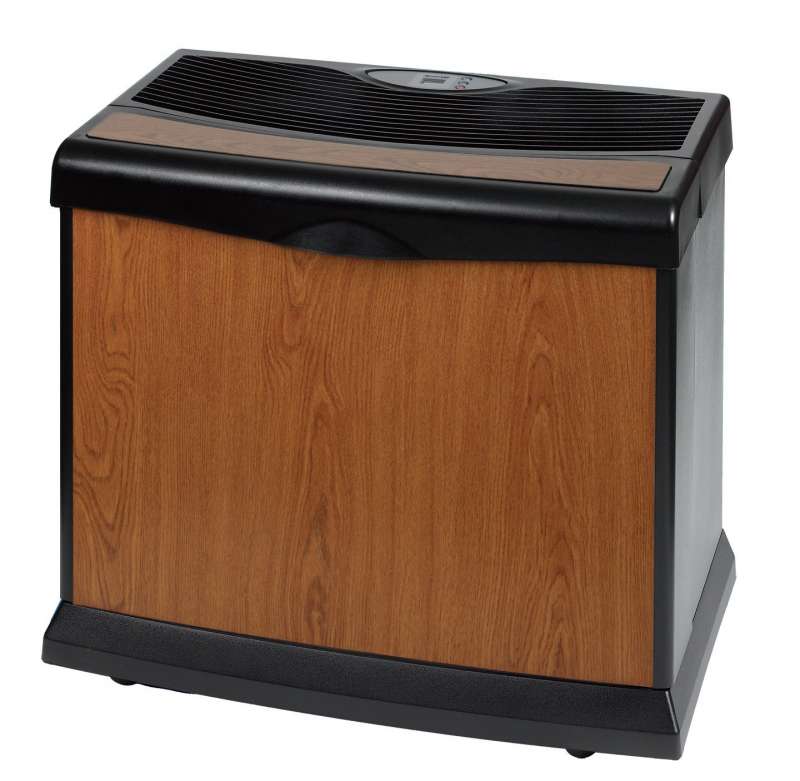

Geno wrote: We use one now that holds a little over 5 gallons and puts out 14 gallons per day. We can keep humidity wherever we want it. It would just be nice to not have to fill it all the time, although Sandra has filling duty during the winter. :tounge2
Geno I have implemented several humidifiers just like that with a couple float switches and a fill valve. Never have to fill it again just need a water line available.

That would be cool. It sits a few feet from the fridge and I guess I could split the line from the ice maker. :clap

So I have to mention this about the humidifiers I work with. Geno you said that the one you posted can put out 14 gallons per day. Well in this industry we typically use Lbs/Hr. So in your case, your humidifier would put out 4.86 Lbs/Hr. Which in the residential world is quite a bit.
Now the humidifier I am currently re-designing has the capability to output a maximum of 1330 Lbs/Hr. If we transfer that into gallons per day that is, 3,827.33 Gallons a day! This type of humidifier would typically be used in either the pharmaceutical industry or in a hospital to maintain RH across a whole wing or even an entire floor!

The two float system is a bit trickier than a single float system. I would look for a single float with a travel distance of anywhere from an inch to 4 inches, depending how deep the tank is.
A switch like this could be used. www.fluidswitch.com/pages/documents/FS31...witchProdSht_000.pdf
Then you wire the hot or neutral directly through that switch to the new fill valve (assuming the valve is 120 VAC).
But all of this could change depending on the internals of the humidifier and what voltages are inside.. :smile2
