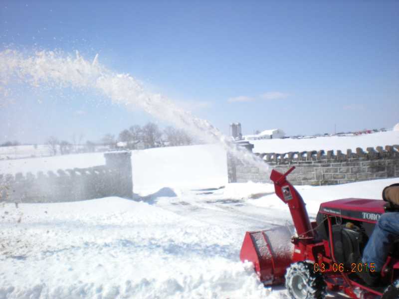

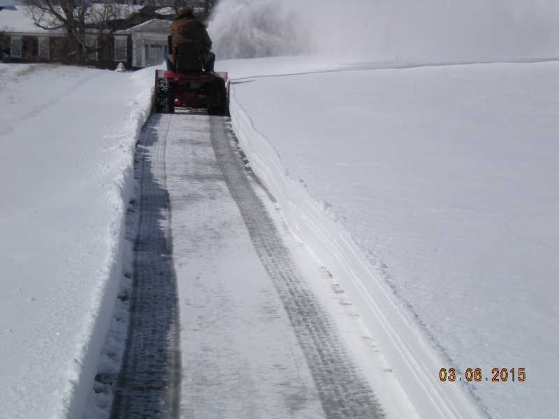

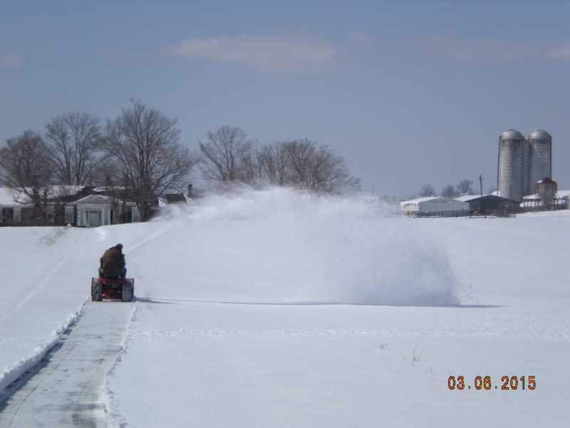

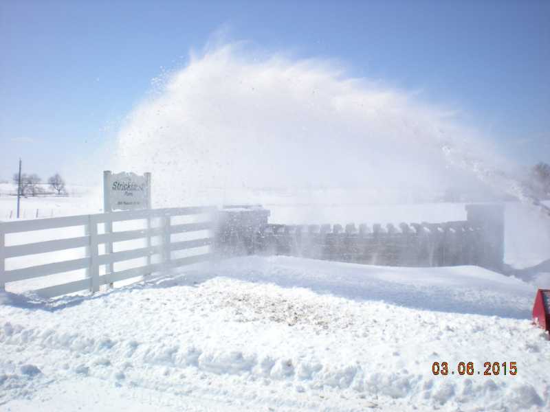

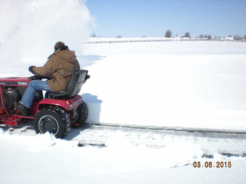

Here's a reminder of how awesome the 2 stage blower is. :bliss

That still amazes me. Nothing like a Horse. :thumb
