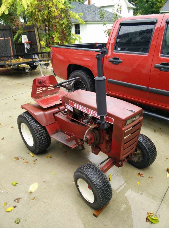

Hi all, and thanks for all the immediate replies. I did locate a set of seat springs from another Wheelhorse, and the low back seat I bought was able to be bolted to the springs. Problem now is, the seat pan bolts require that the seat and springs be mounted all the way forward due to the flip open style of seat pan (nifty toolbox area under seat pan) I'm not tall, but my knees hit the PTO engagement and the deck lift arms. Very uncomfortable. Just wish I could find the right style of seat to be able to enjoy this little old tractor a bit before we tear it down to begin restoring. Attached is a photo of the snow plow attached, sans the lift link I have yet to go and pick up. Love this little tractor. Wish I had a C160 parked next to it.

18 Mar 2015 21:12 #1330 by Geno
Replied by Geno on topic Seat Help Please?
There should be 3 sets of holes there to adjust it forward and back. Looks like you can go back 1 more hole and bolt the spring through the pan mount. If you remove the springs you can go all the way back. That tractor didn't come out with springs so they get in the way if you're going to the last hole rearward.
Some springs are offset to, if you flip them it moves the seat. :)
